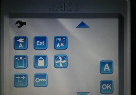

KÄYTTÖOHJE OHJAUSPANEELI 3010 :
Jos valitset sekä kaasun että sähkön, järjestelmä käyttää sähköä ensisijaisena energialähteenä.
Uuudella 3020 saa:

http://www.alde.se/usa/contact-us/press/alde-compact-3020/
Alde Compact 3020
Alde proudly presents their new heating system, Alde 3020 Compact.
The heating system has a new control panel with many refinements and new functionality, including integration into a full climate control system. Alde 3020 Compact can be also equipped with an advanced options dongle, allowing premium functions such as engine heat exchanger, booster fans, floor heating and auxiliary hot water cylinder to be controlled directly from the control panel. Exciting new features are selectable priority between gas and electric heating, and programmable full on-off for night time mode.
Alde 3020 Compact is approved by New Standard ECE R122 & R10.
The design principles and products for the heating circuit remain the same as the Alde 3010 Compact.

Tässä toimiva linkki. http://www.atstuonti.fi/File/K%C3%A4ytt%C3%B6ohjeet/Alde/Alde%203020%20v%C3%A4rikosketuspaneeli.pdf
