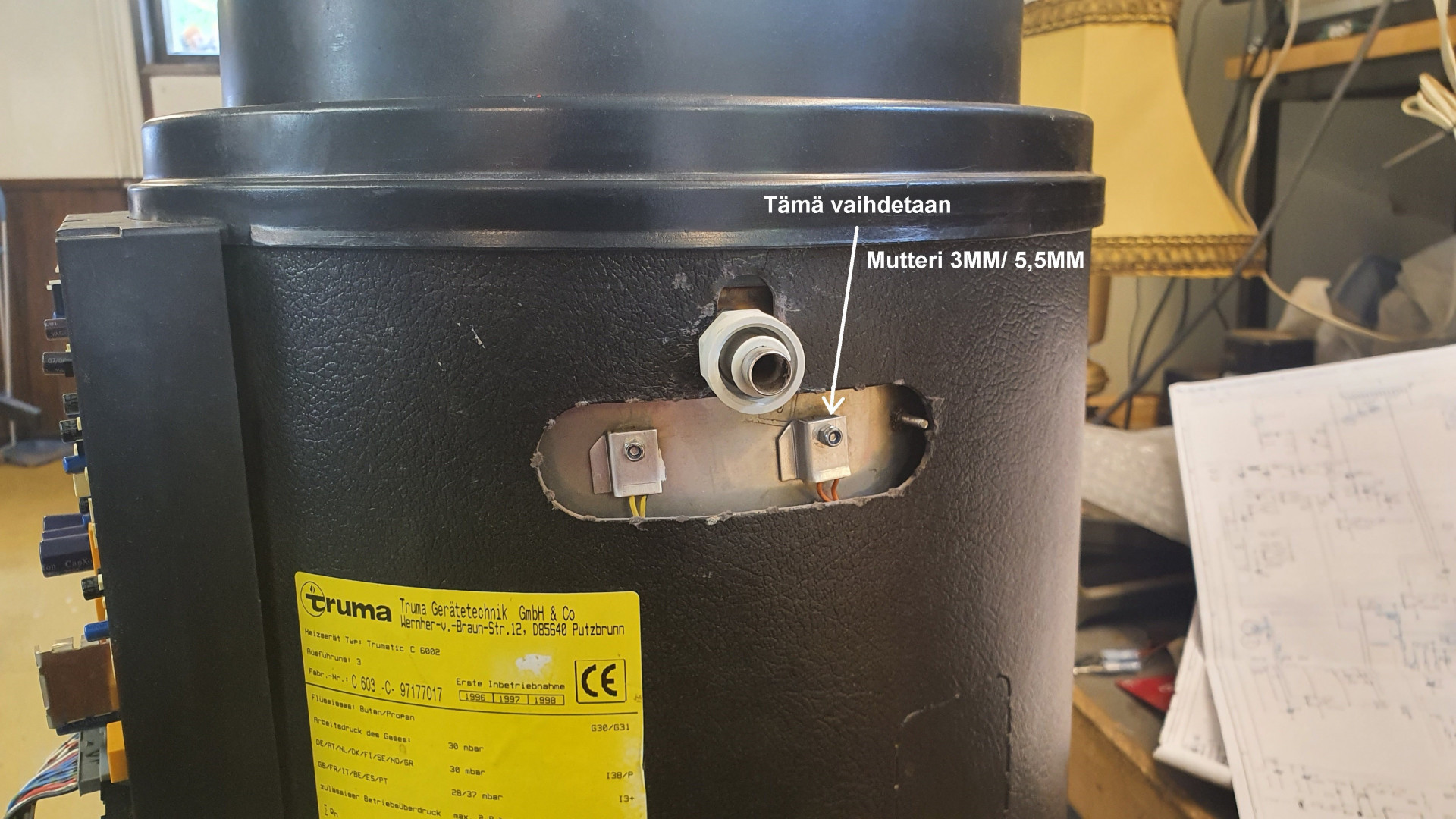

This morning i measured all of the three temperature sensors and water temperature sensor didn't quite follow resistance/temperature relationship. So I disconnected it primarily to check if the boiler housing itself overheats or not with K-thermocouple and it holds at around 60c (without water) dial setting 6.
Pictures two and three.

If it turns out that it works ok, with water temp sensor dangling as is , is there already "known" substitution NTC or should I look for one with similar characteristics and preferably through hole mountable ?
Thank you.
  • Viimeksi paikalla:28.11.2025 kello on 03:02
Vs: Trumatic C 3402 (C343) probable overheating
« Vastaus #4 : 8.03.2025 kello on 09:27 »
I've searched online for truma sensor and found it a bit too expensive (75€) .
So I found matching NTC and bought 5 of them for 1€ . Placed it in cable end with eye, some epoxi glue and made me a diy through hole NTC.
Attached are photos of temp measurements. Water temperature is held at 65-70c when in heating mode . Real test once we go to sub zero temperatures .
